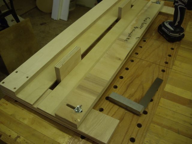

Here ya go, Fred.
First pic shows the jig with two pieces of 3/4 scrap between the guides. Just snug up the guides and lock it down with the wing nuts.
After the two guide parts are constructed, the 1/8 piece where the router rides (bearing against the scrap) is trimmed with the router and bit that will be used for the dadoes. So, it will only work with the same bit and same router used to trim.

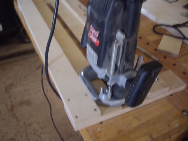

Here it is with the router and a 3/8 bit. Just rout up one side and down the other.

Might just have to make me up a jig like that. Have a few simple cabinets to make and a little big for the table saw.

That's a nice jig and it works very well!
I found I had to slightly modify the base on my Porter Cable router. The plastic base is round but not perfectly centered on the router housing. Ground a flat side on the plastic base to assure keeping the same side of the router against the edge guides of the jig.
